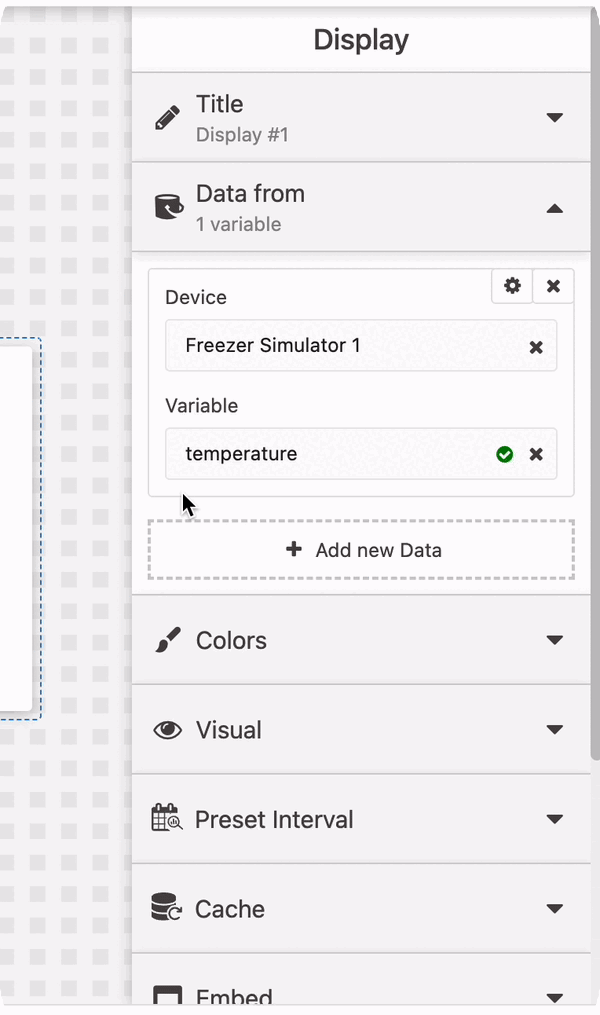

You can easily apply functions by entering your widget in Edit Mode, selecting a variable in Data From, and clicking the cog icon to access the Data Analytics tab. Check which widgets support Data Analytics in the table at the beginning of this document.

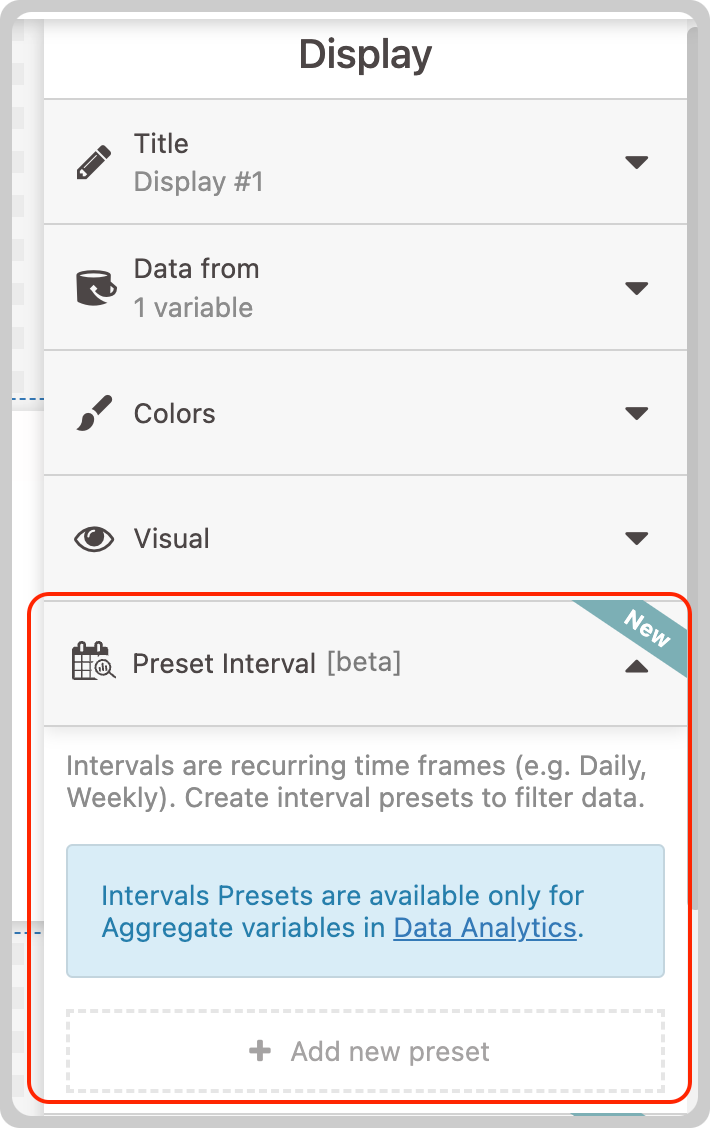

For basic calculations, you define a period, which may be configured in the Data Analytics tab, on the X-axis, or by defining global preset periods on your dashboard using the Dashboard Period Presets.
For the aggregation function, you set a default interval or create a preset interval by navigating to the Preset Interval option after entering the widget in Edit Mode.
