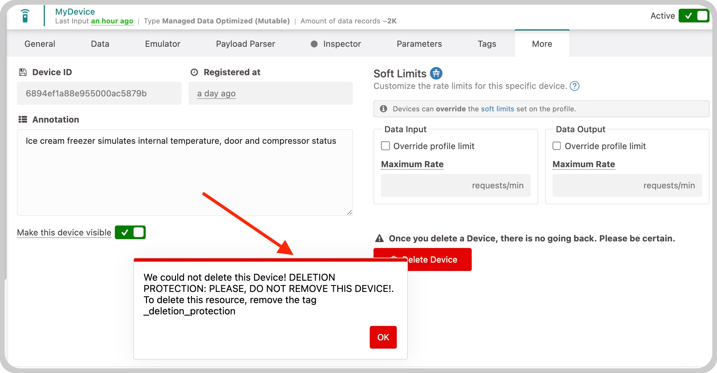

4. Protecting your resources from accidental deletion using Tags
TagoIO has a built-in delete protection feature that prevents accidental deletion of your resources​ via both the interface and API. It can be extremely useful for safeguarding critical Tags that if deleted, could brake your application. This applies to everything that supports tags like Devices, Entities, Actions, Dashboards, Access Management , Analysis etc.
To enable it, simply add a specific value to the resource you want to protect.
When the protection tag is present on a resource, any attempt to delete it will be blocked and result in an error or warning that you can customize.
4.1. How to use
To enable delete protection, add the following tag to the resource:
  1. Key: _delete_protection
  2. Value: Custom error message to display when deletion is attempted
Once this is done, attempts to delete this device will be blocked until the tag is removed. To unlock your resource from deletion, simply remove the tag.
