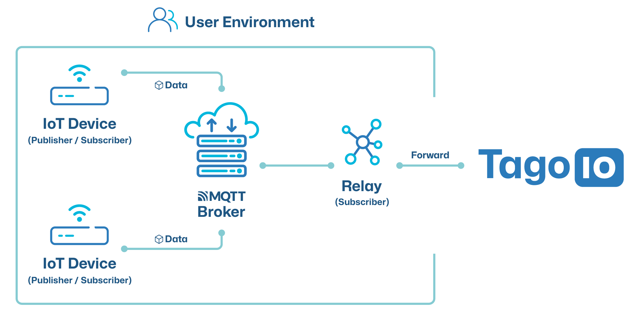

The TagoIO MQTT Relay connects to your MQTT Broker on predefined topics and redirects the information to your Devices. It leverages TagoIO's Integration Network and Connector, along with an Authorization Key from your Profile, to ensure secure and efficient data transmission.

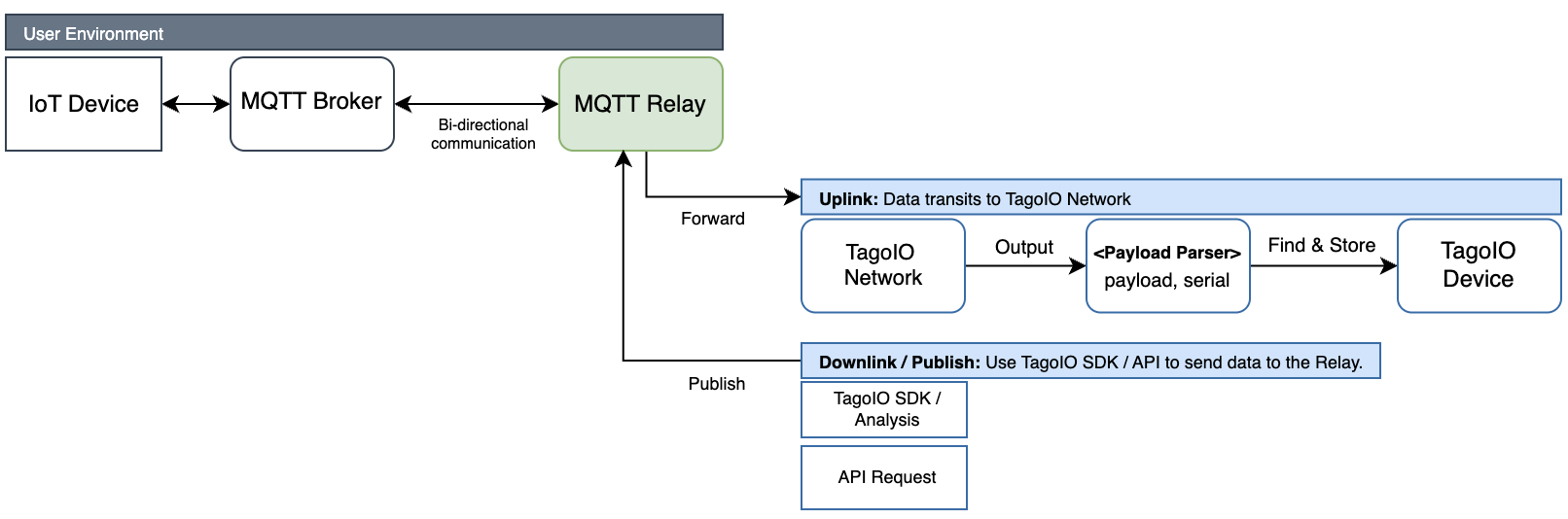

The diagram above illustrates the data flow process. The Relay connects to your Broker and listens on a configurable subset of topics, enabling bi-directional communication. This means the Relay can also publish to topics using standard TagoIO tools such as the API and SDK.
How It Works
Data Flow
  1. MQTT Broker Connection: The Relay connects to your MQTT Broker and subscribes to predefined topics.
  2. Data Redirection: Incoming data on these topics is redirected to TagoIO Devices.
  3. TagoIO Network Integration: The Relay utilizes TagoIO's Integration Network and Connector to process and store the data.
  4. Device Identification: A Payload Parser within the Network exports a Serial, which TagoIO uses to store the information in the correct device within your Profile.
