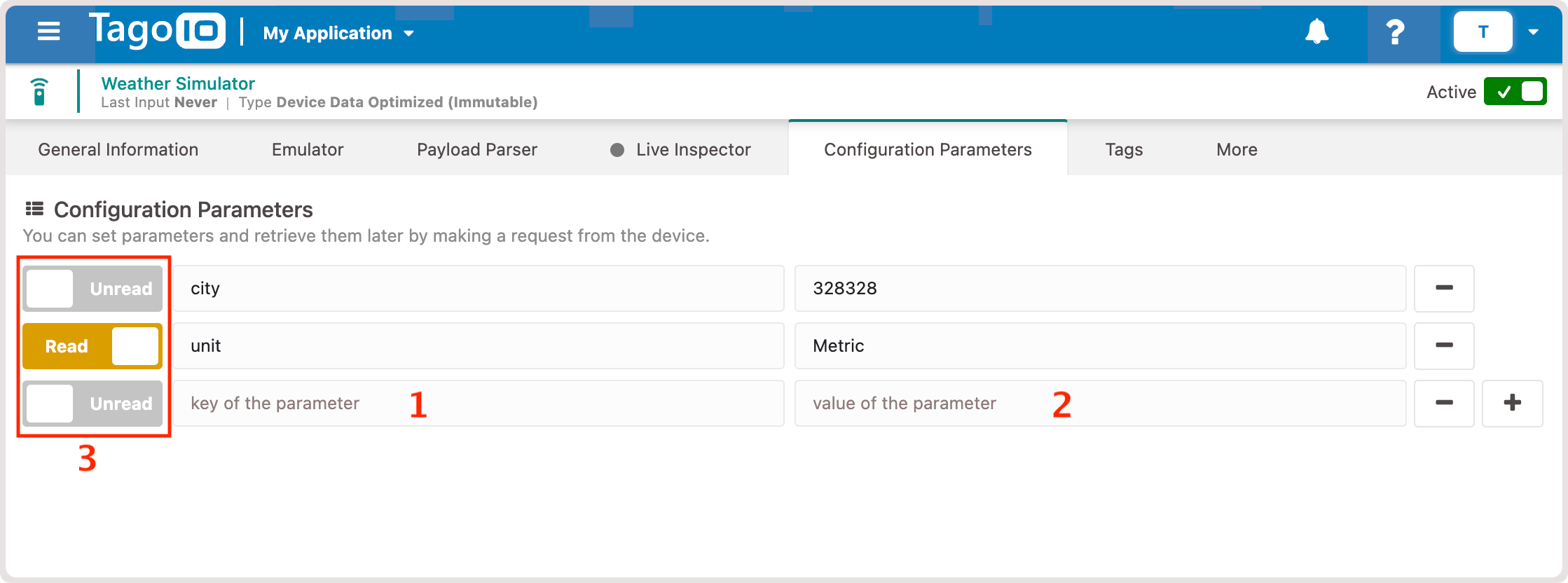

Configuration Parameters are stored on the configuration page of your device. You can access it by clicking on the Devices module on the left menu and selecting a device. You will see a tab called Configuration Parameters, where you can add, edit, or delete them.
Each Configuration Parameter has three configurable fields:
  1. Key:  name of the parameter that you can use to reference in your code or widgets.
  2. Value: the value of the parameter you want to assign to your device.
  3. Read & Unread: boolean value (true or false) that indicates whether the parameter has been sent to the device or not.
The maximum number of parameters per Device is 60.
If you attempt to add additional items beyond the limit, a notification will appear indicating that the maximum capacity has been reached.
