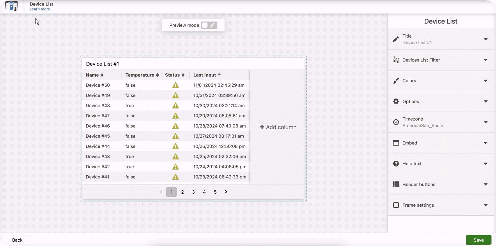

The Device List widget is a table that dynamically populates with information about your devices, such as names, tags, configuration parameters, and IDs. It can't access devices' data, however.
1. Editing the device list
It works as a dynamic table, as you can customize its colors, columns, and filter which devices will be shown in the list.
Setting up device filtering
 To edit a specific section of this widget, you must hover over the desired element and click on it. Promptly, a new page will appear on the right side with all of the editable options for the selected element.
2. Device filtering
This option is required to be filled up in order to show your devices. You can either filter the devices that will show up in your list by the devices' tag key and tag value, or by tag match for one of the blueprint devices on your dashboard.
You can also have multiple filters working at the same time. It works as an AND operator, and the device must match all the filters.
You can easily set up tags on your devices by accessing the Device's page.
a) Filter by Tag Key and Tag Value
All devices for the list must have the same tag key and tag value specified by you in this filter.
b) Match with Blueprint Devices tag
You must select a blueprint device from the dashboard and one tag key.
The devices for the list must match the same value of that tag key in the selected blueprint device of the dashboard.
