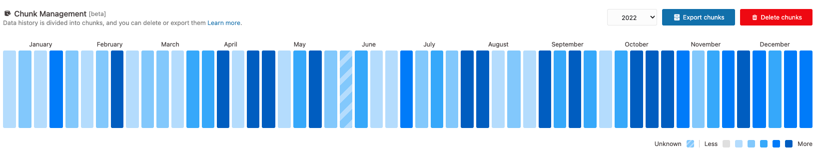

The Chunk Management feature is a powerful tool that allows you to easily manage the data of your Immutable devices, either to create backups or delete information.
By accessing the Device module and selecting a Device Data Optimized (Immutable) device type from your list, you will be able to find the Chunk Management section where there's a graph that shows your data chunks based on the period you chose when creating your device.
Export chunks to TagoIO Files
By selecting one or multiple chunks, you will be able to export them to your TagoIO Files in CSV format to create a backup of your data. In this process, the chunks are added to a queue and soon become available on the file address. This process can take several minutes, depending on the amount of data being exported.

You can delete chunks to optimize your data storage. This is an irreversible process, and once done there is no going back, so make sure to be certain before removing anything. You can check the chunk range information by hovering your mouse over the graph before deleting the data.
