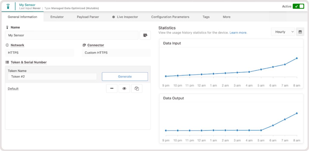

Once you activate Control Tower, you can view data input and output statistics for each device under your profile. This allows you to better understand how much data is being streamed to and from your devices.
You can monitor the statistics by going to your Devices module on your Admin and selecting the device you want to visualize the statistics.
The statistics starts being stored once the add-on is added to a profile, meaning that adding Control Tower does not generate statistics for devices retroactively prior to the date of purchase.

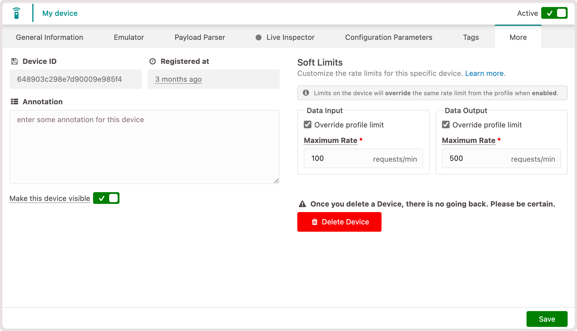

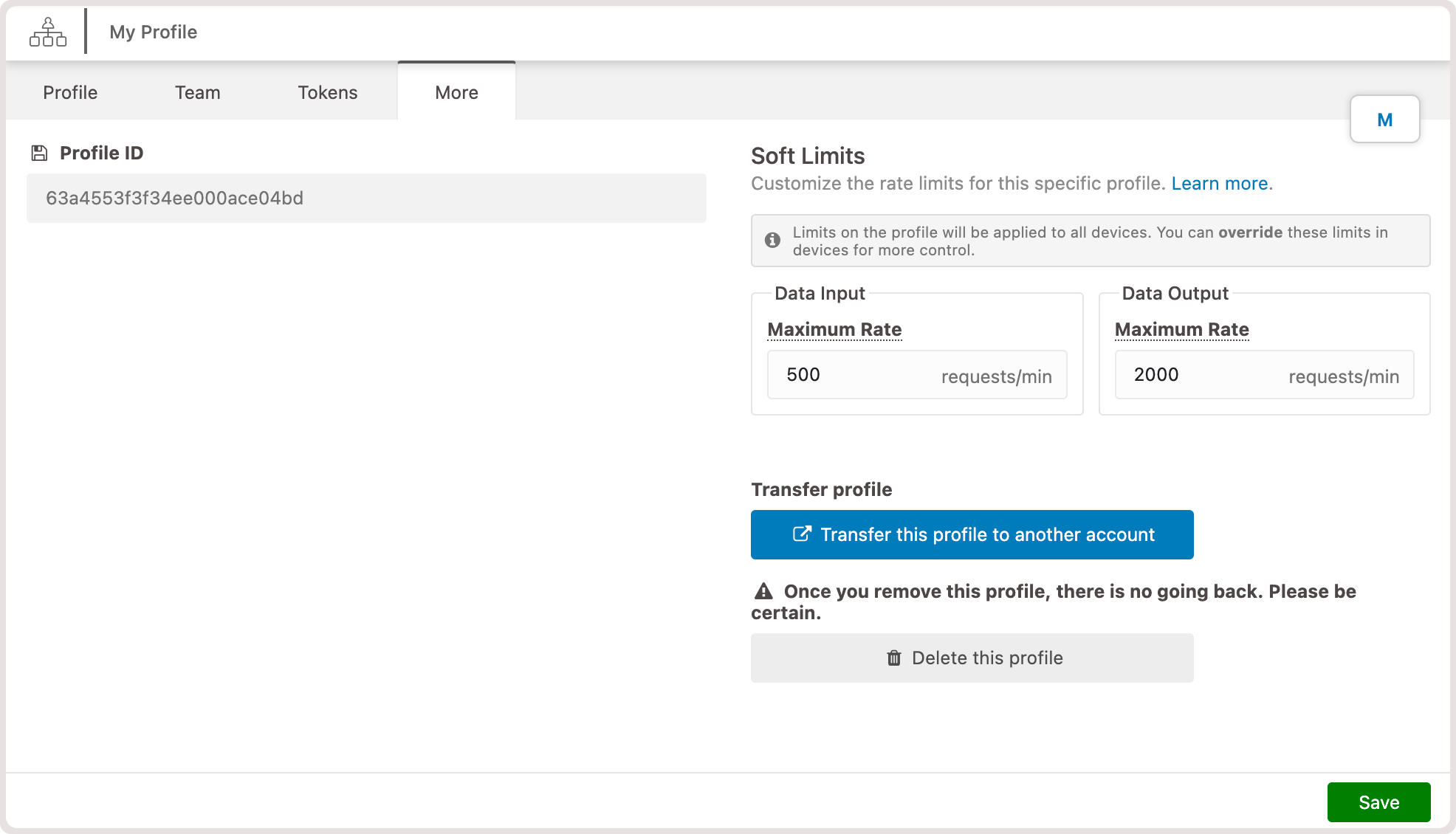

You can apply soft rate limits to your whole profile, so that all devices in the profile follow them. You can also apply a soft limit to a specific device, which will override the profile limits, this can be useful when you need a certain device to have more or less limit than the others.

To customize the soft limits for a Profile, navigate to your Admin page, access the Profiles & Teams page, and then proceed to the "More" tab.
For managing device soft limits, go to the Devices module, select the desired device, and similarly access the "More" tab.

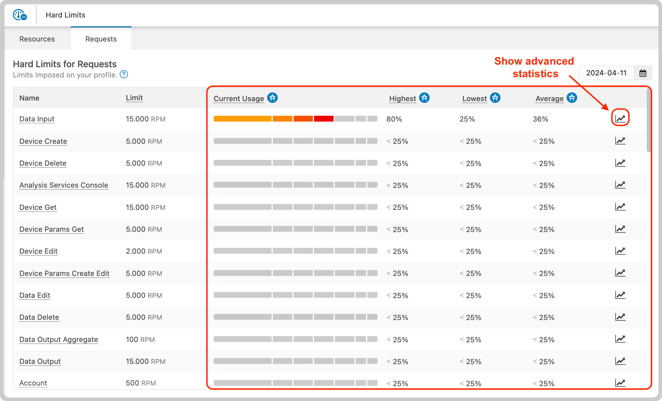

Monitor your request per minute statistics

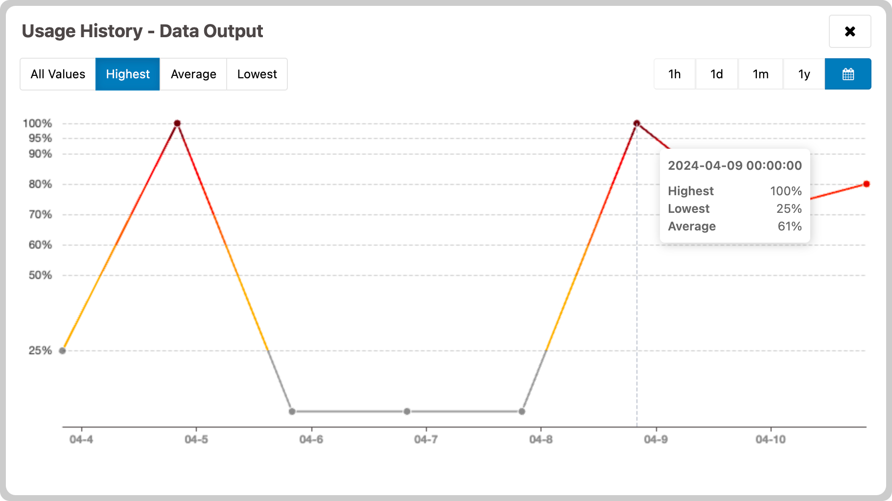

A significant feature provided by the Control Tower is the capability to access detailed statistics on Hard Limits through your Admin page. Upon activating the add-on, data regarding your requests will begin to be recorded and presented on the Hard Limits > Requests page. This enables you to view the current, highest, lowest, and average usage of each hard limit. Furthermore, it allows for the display of advanced statistics, offering a historical view of your usage.
In the advanced statistics view, you have the option to filter your usage by date and time, as well as to view only the highest, average, and lowest usage. This is beneficial for understanding how your application is performing and determining if any actions are necessary to mitigate the usage of your hard limits.
The graph will consistently display a minimum value of 25% for usage, regardless of whether the actual usage falls below this threshold. Even if the usage is 0%, it will be represented as 25% on the graph.
