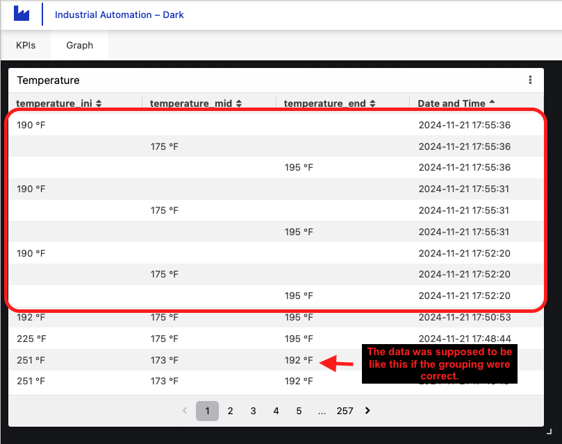

For example, let's say you need to edit a variable named 'group', which is used to organize variables in widgets. Due to a problem with my payload parser, data was added to my Immutable bucket with incorrect grouping. This caused my Dynamic List widget to display the variables in separate rows, as if they were distinct from one another.

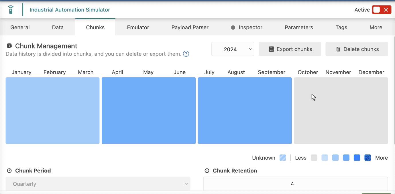

2. Click on the 'Chunks' tab. Select the chunk of data you'd like to fix, and click on 'Export chunks'. This is the data you need to manually correct.
3. The chunk of data will be exported to your Files at the address you've specified. It may take a few minutes. Once the .csv file is in your Files, you can download and edit it.
This will consume your Data Output service.

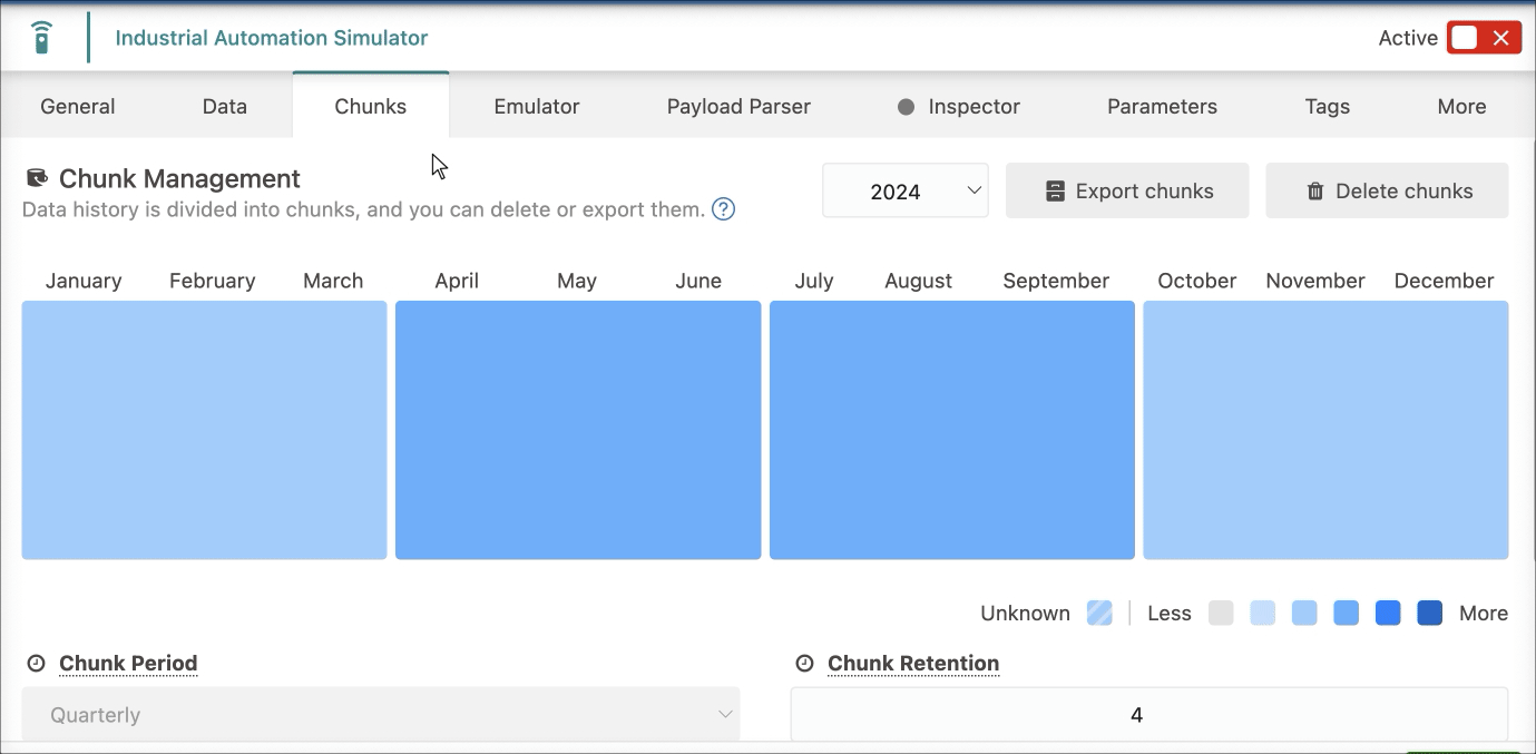

1. Return to the device's 'Chunks' tab.
2. Select the chunk of data you previously exported, and click on 'Delete Chunks'.
3. Confirm the action when prompted. Ensure it is the correct chunk, as this action is irreversible.

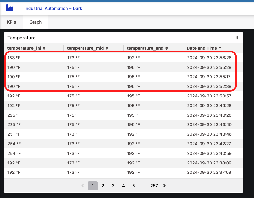

And that's it! Now that the data is corrected with the proper grouping, my data is displayed correctly.
