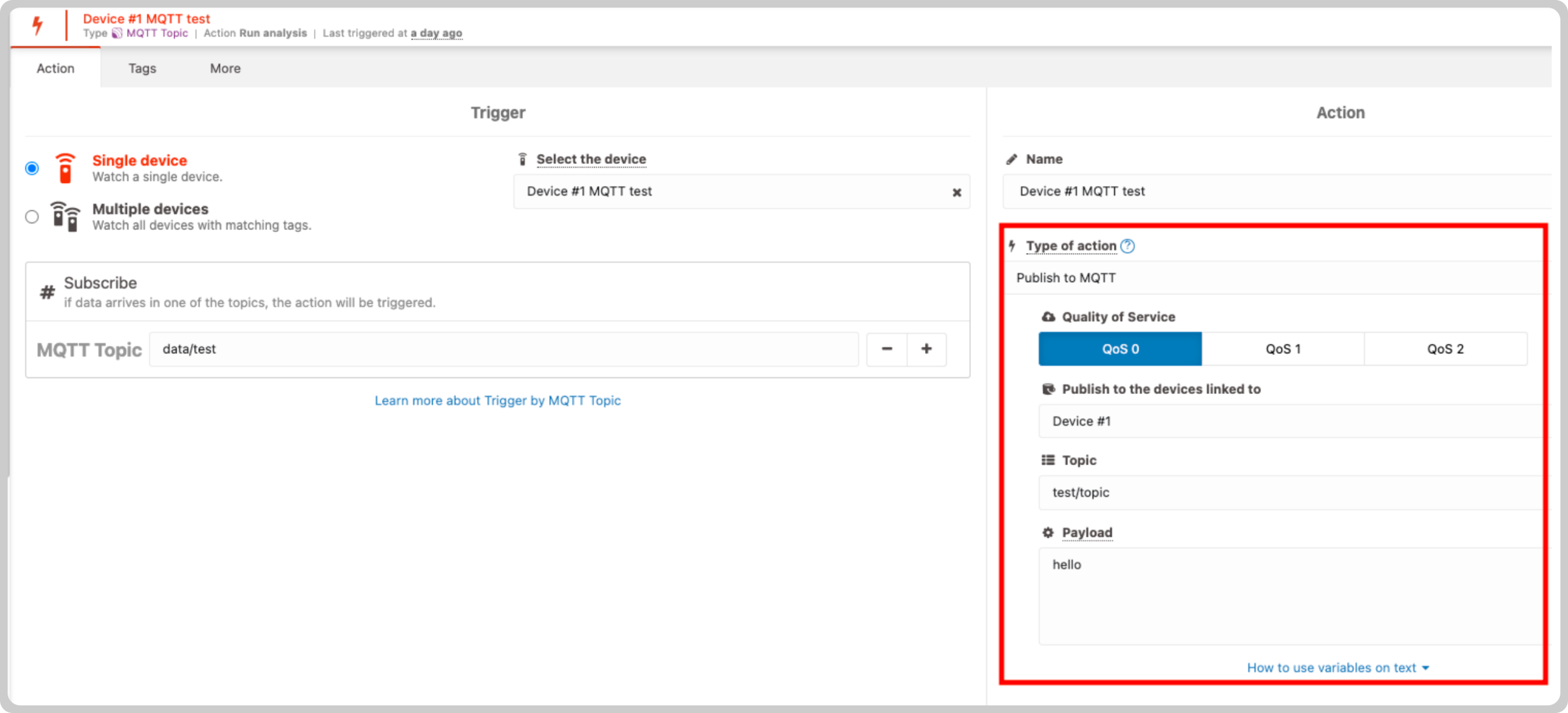

Using Actions to Publish a Message to a Subscriber
  1. Create an Action: Navigate to the Actions section in your TagoIO dashboard and create a new action. Choose the event that will trigger this action. It could be a variable update, a scheduled time, or another custom trigger.
  2. Configure MQTT Publish: In the action configuration, select "MQTT Publish" as the action type. You must specify the topic you wish to publish to and the message payload.
