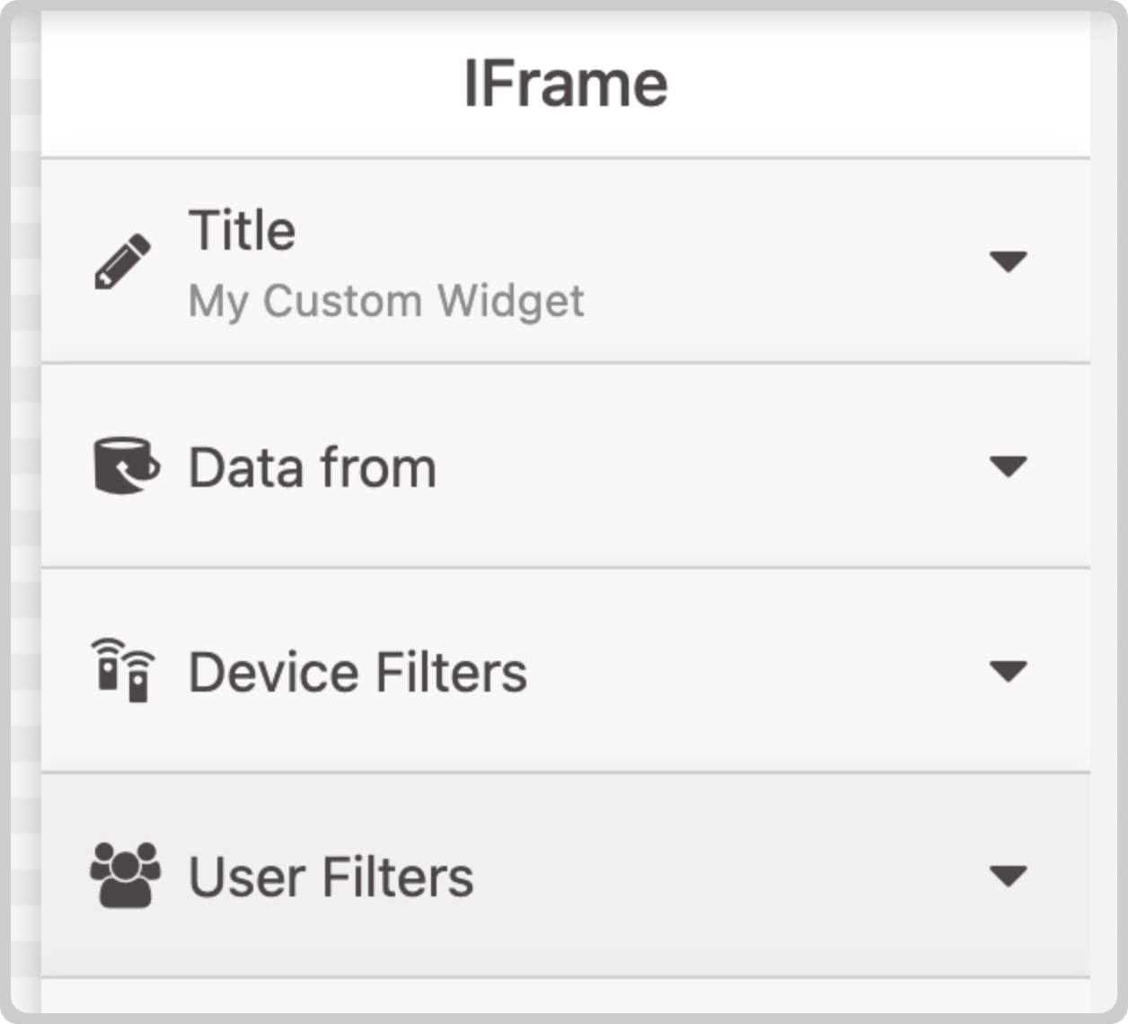

Due to their versatility, Custom Widgets allow you to use data from different sources in TagoIO.
You can use data stored in your device’s variables by configuring your devices and the variables in the Data from section of the widget’s configuration.
You can also use data from resources such as devices and users – just like on the Device List and User List widgets – by configuring the tag filters in the Device Filters and/or User Filters sections of the widget’s configuration. It’s possible to build your custom logic by mixing data from different data sources, such as getting data from variables and combining them with Devices/User.
