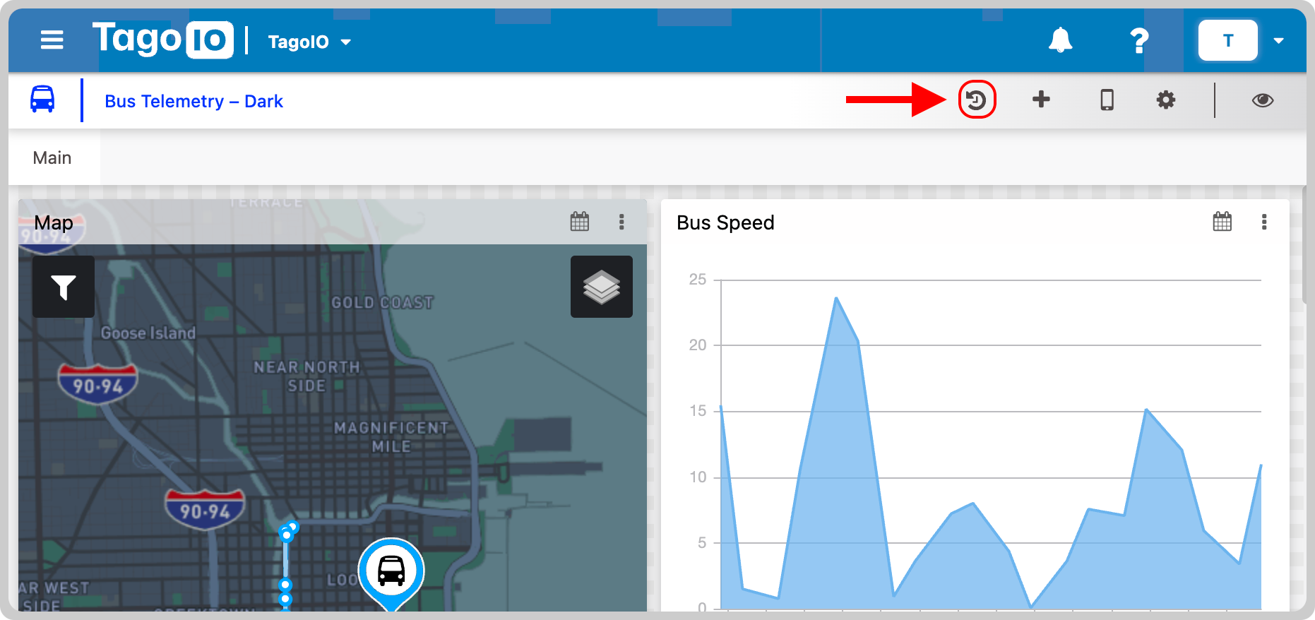

To access this option, enter your dashboard in edit mode and click on the 'Restore dashboard to a previous version' button.

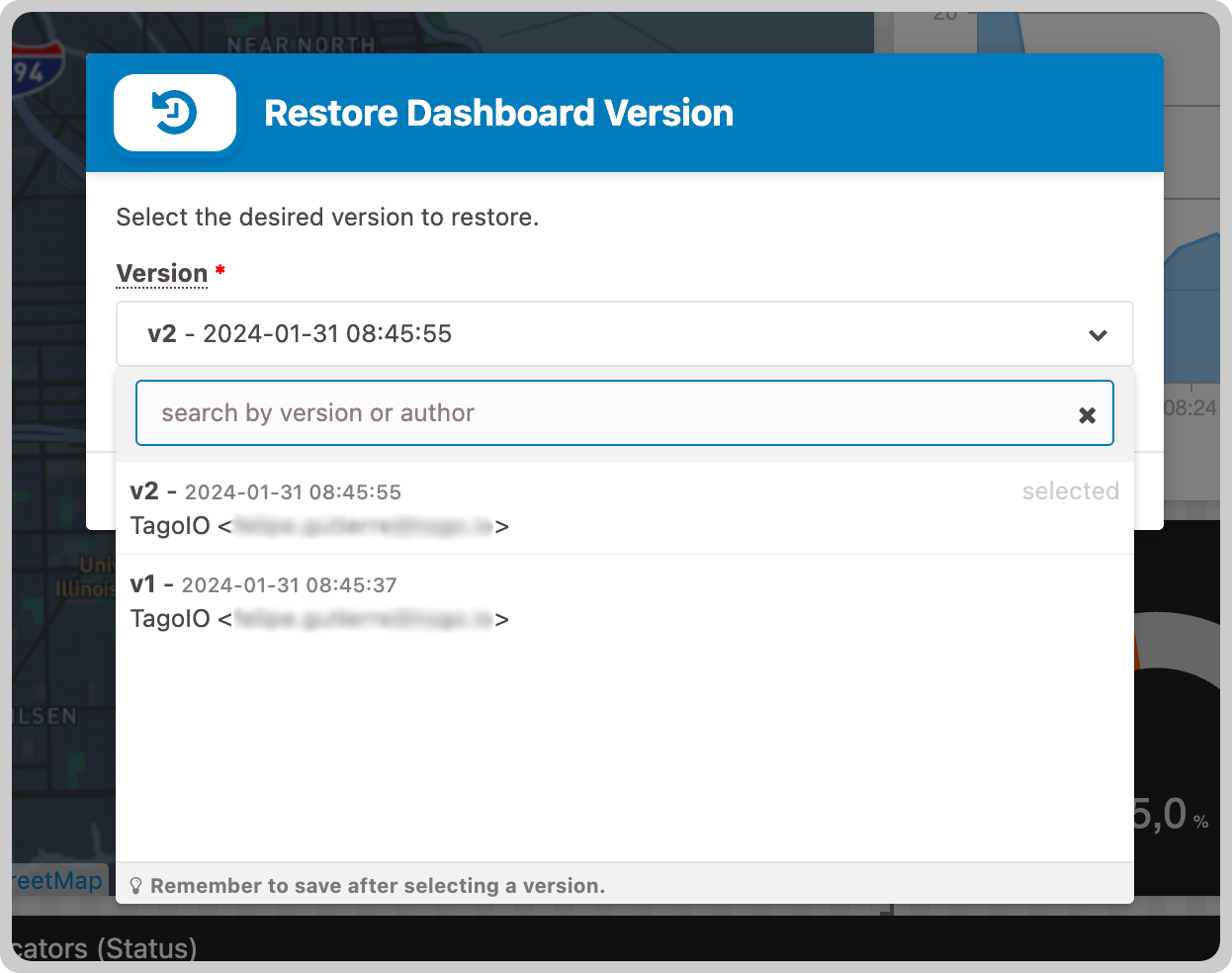

Here, you will find a chronological list of your dashboard versions, each timestamped.
The number of versions you can have is predefined by your plan. Please refer to the table below for detailed information on the number of versions available for each plan:

Every time you restore a version, the system creates a new version post-restoration. This ensures that you maintain a comprehensive and uninterrupted historical record of your dashboard's evolution, allowing you to track changes and keep a clear overview of your dashboard's development over time.

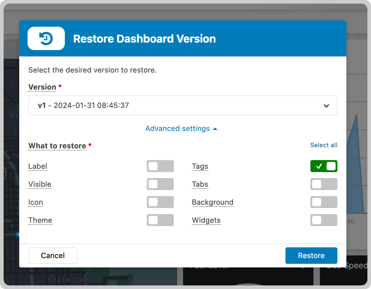

In the 'Advanced settings' section, you have fine-grained control over what is restored. For instance, if you want to retrieve only the tags from a previous version that integrated seamlessly with your application, you can do so with ease. Simply select the tags, and the system will comply, leaving all other elements as they are.
By default, the system is set to restore the entire dashboard.
