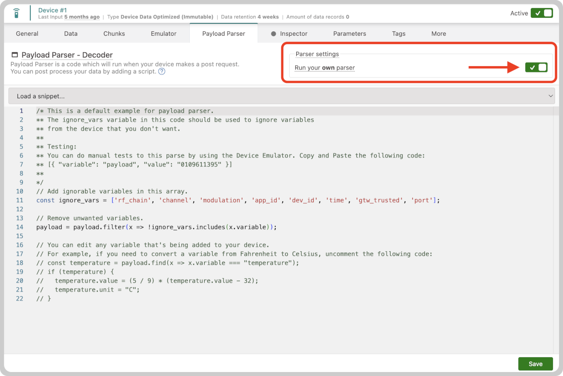

For example, if your device is sending data from TTN as shown in the image below, most variables will be created in the device's data storage, including the payload.
A variable called location is automatically created by combining the fields 'latitude' and 'longitude'. Use location when plotting maps.
To ignore the variables so that they will not be added to your Device, go to Devices at your Admin panel, find your device, and click on the 'Payload Parser' tab. Then, enter the names you want the parser to ignore on the ignore_vars. See the image below for reference.
As a reference, the image above shows that no variable would be ignored, meaning that all fields and metadata would be posted to the device each time the sensor sends data.
We offer this flexibility to allow you to optimize your storage by avoiding the creation of unnecessary variables.
