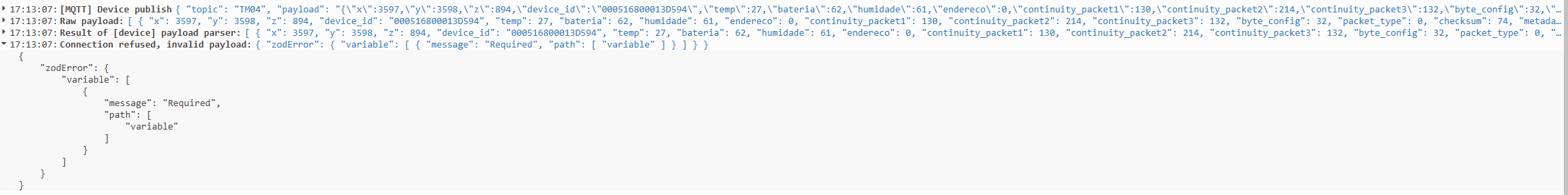

Hello everyone! I need your help. I'm connecting a device via MQTT but I'm having a problem entering the data. I've already connected another device to the tago and it was pretty smooth, but this one is giving me these problems below in the photos:

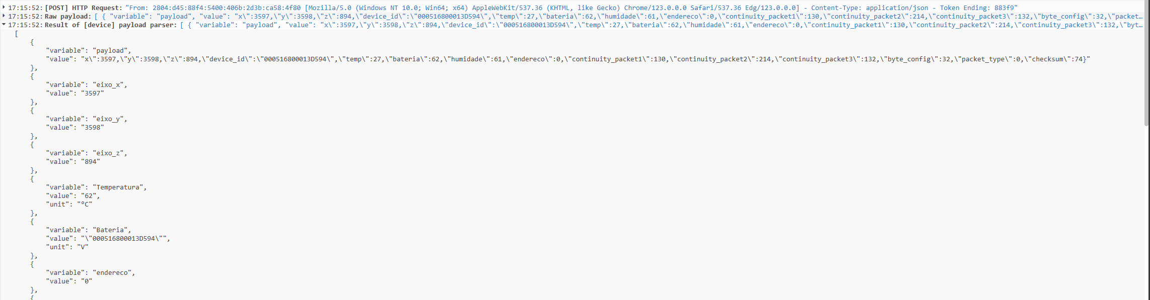

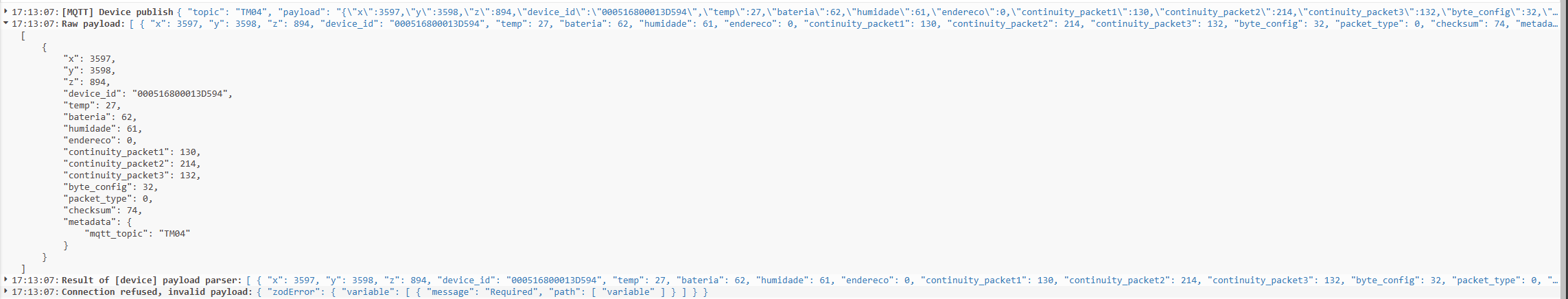

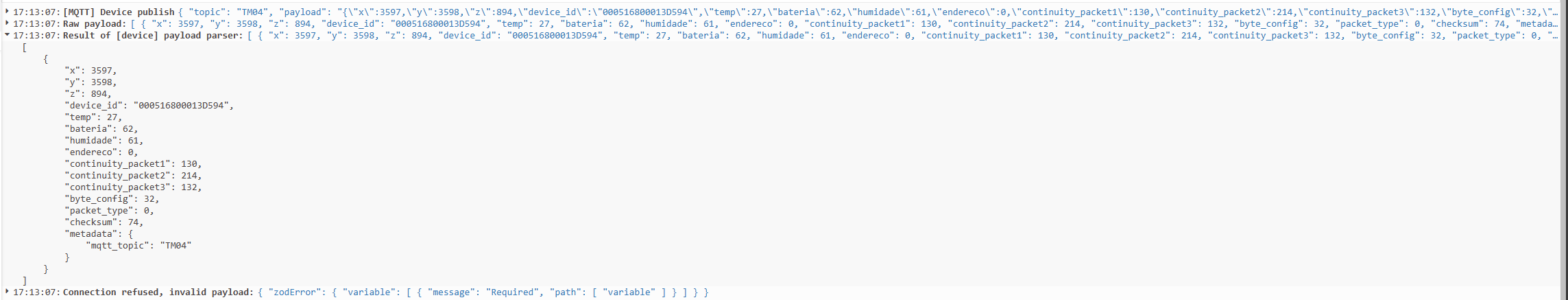

The raw_payload ends up not being in the correct format so that you can search for the data and filter it to display on the dashboard. It doesn't stay as a variable and ends up giving this error. However, it arrives as a payload variable from my device.

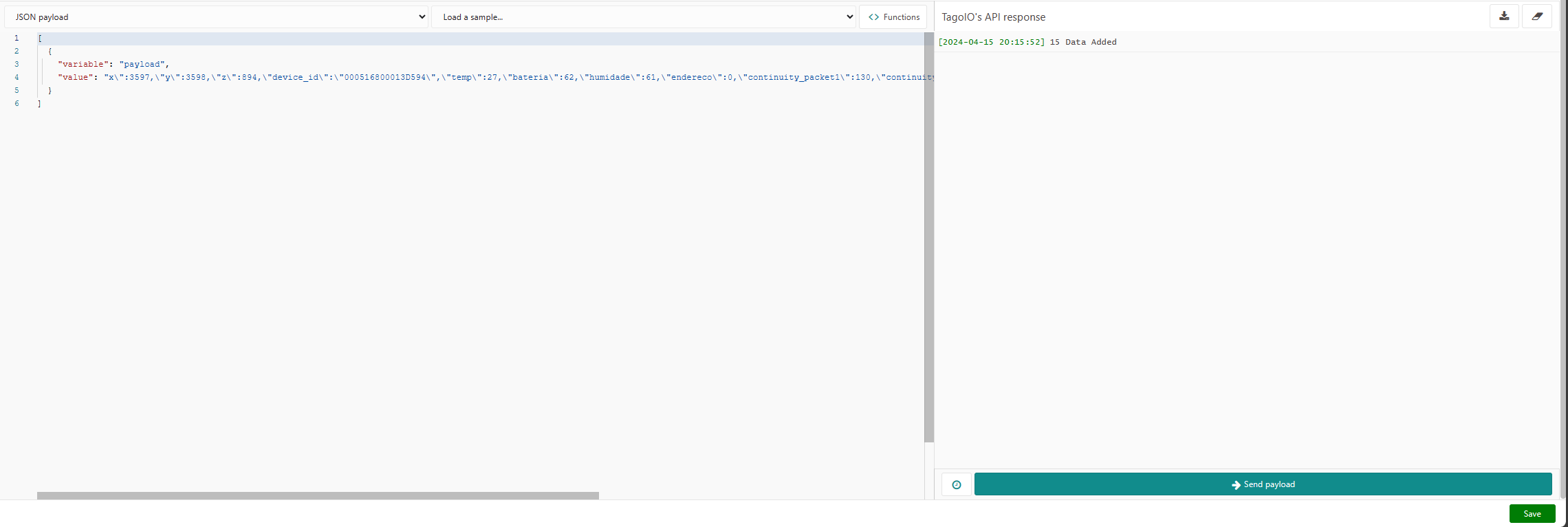

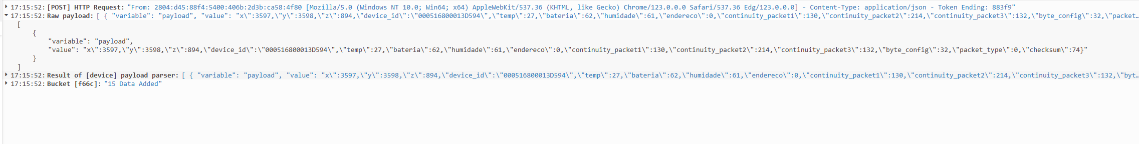

If I use the emulator with the payload variable and the data as the value, then it inserts it into the bucket and runs normally.
Does anyone know what I'm doing wrong or what I can fix so that my raw_payload is in the variable/value format so I can get the data?
Agradeço pela ajuda.
