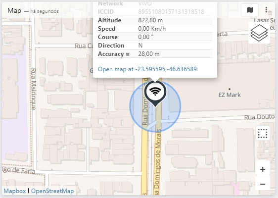

Dear all,
I had to draw a circle around the device last location and did some workaround:
1. added a variable to the payload, "range" as a fence format:
  "variable": "range",
  "value": "Range: 36.75",
  "location": {
    "type": "Point",
    "coordinates": [
      -46.63629,
      -23.595664
  "metadata": {
    "event": "Accuracy: 36.75",
    "eventColor": "black",
    "geolocation": {
      "type": "Point",
      "radius": 36.75,
      "coordinates": [
        -23.595664,
        -46.63629
2. Changed geofence options in the widget to show only one value for the  "range" variable.
Then the result is this:
Would be nice if the map widget have this feature (location.radius or metadata.radius or metadata.geolocation.radius  ) on the variable without adding a new variable to simulate it.
Color option and a button to switch on/off the view also would be welcome.
