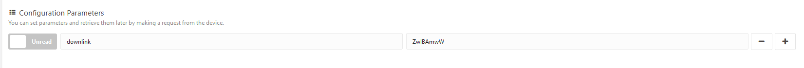

It almost worked because it created the downlink in the configurations parameters, port however is missing:
Am i missing something :( ? Could you help?
