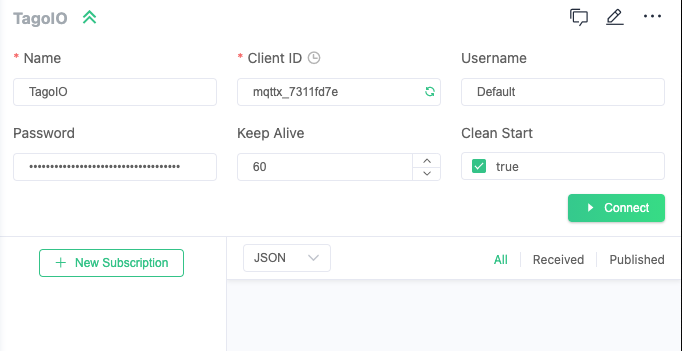

Hello everyone,
I don't know if something is happening, but I'm trying to connect with MQTTX and it only gives me the wrong username or password. As instructed, I put the token as the password and the username is the name of the token, both from the device.
Is the client ID necessary? If so, where can I get it on the tagoIO platform?
In my aplication from Esp8266, can't connect:
  1. // Configurações do MQTT (TagoIO)
    const char* mqtt_server = "mqtt.tago.io"; // Broker MQTT do TagoIO
    const int mqtt_port = 1883; // Porta MQTT padrão
    const char* mqtt_token = "5a77969b-7544-4ed1-af5d-35d9d7e4a364"; // Token do dispositivo no TagoIO
    const char* mqtt_topic = "sensor/data"; // Tópico MQTT para enviar os dados
    const char* id_profile = "6712ab41ec9a8000097c7103"; // ID do dispositivo TagoIO
And my connect:
  1. void reconnect() {
    // Loop até reconectar
    while (!client.connected()) {
    Serial.print("Tentando conectar ao MQTT...");
    // Cria um ID de cliente aleatório
    // Create a random client ID
    String clientId = "ESP8266DHT";
    clientId += String(random(0xffff), HEX);
    // Attempt to connect
    if (client.connect("ESP8266DHT", id_profile, mqtt_token)) {
    Serial.println("Conectado ao MQTT Broken...");
    // Once connected, publish an announcement...
    client.publish("outTopic", "hello world");
    client.loop();
    else {
    Serial.print("Erro ao conectar, código de erro: ");
    Serial.print(client.state());
    delay(5000);
Can someone help me?
