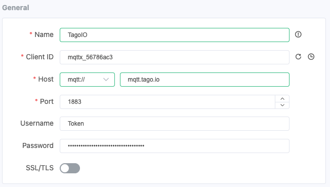

Open MQTTX and create a new connection
On the Connection screen, set the following information:
Host: mqtt.tago.io
Port: 1883
Username: "Token"
Password: “Your device token”
Client ID: Can be set to any unique identifier
The Client Identifier (ClientID) is a required field to connect to the TagoIO MQTT Broker.

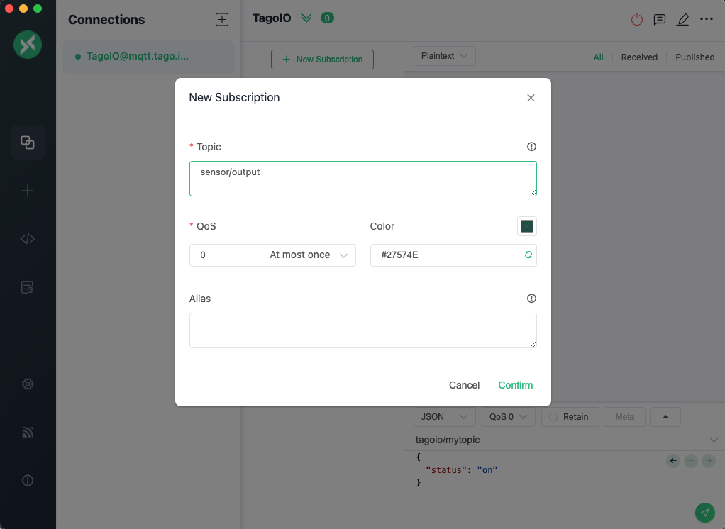

Subscribing to a topic

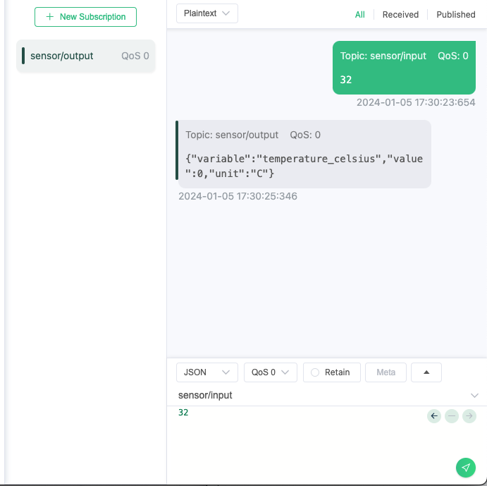

Now to subscribe to a topic just go to the subscribe section, type "sensor/output" and click subscribe.

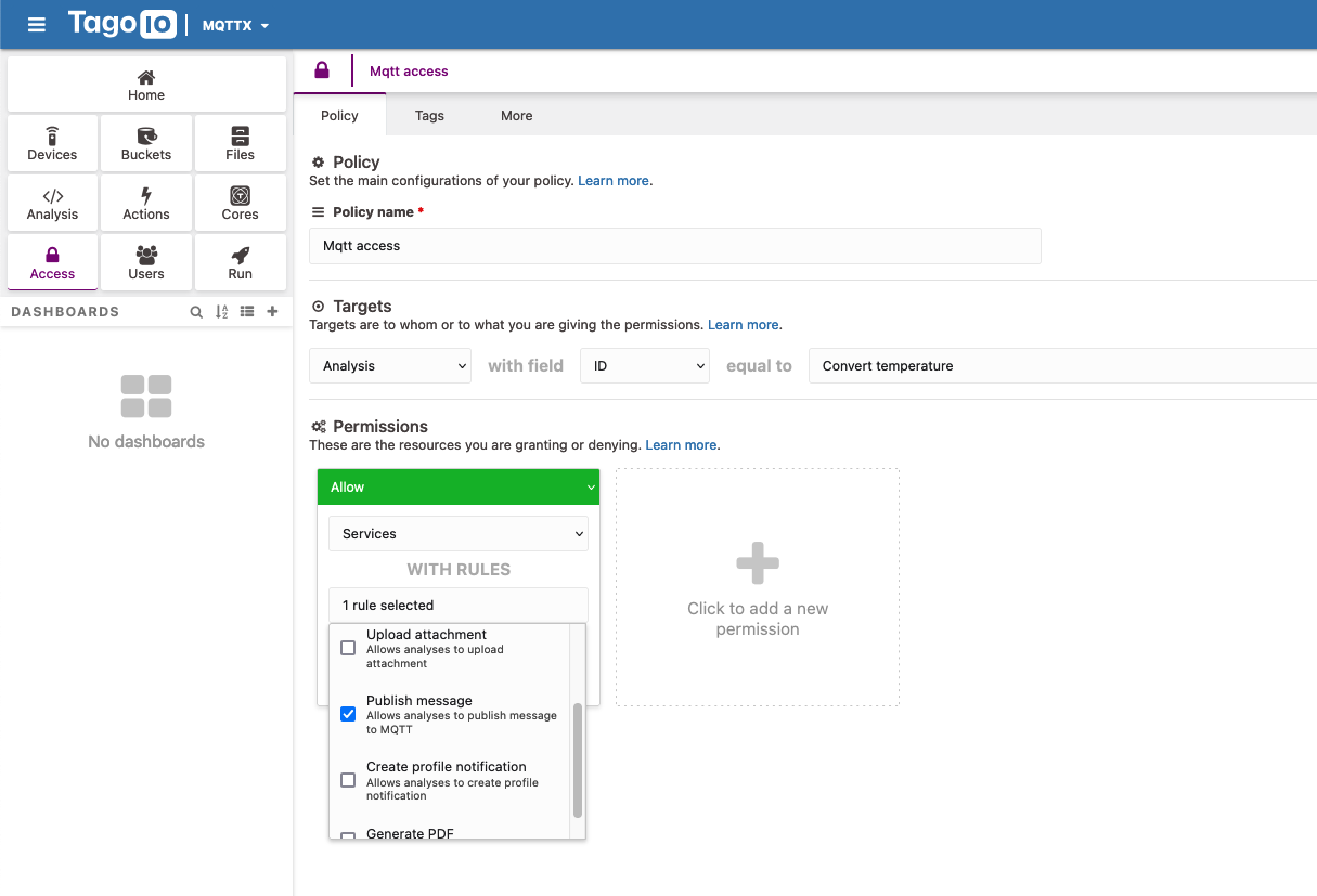

This analysis requires permission to send MQTT data to this device. Let's enable this access in the Access Management module by creating a new Policy settings screen.

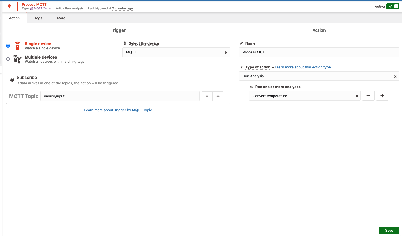

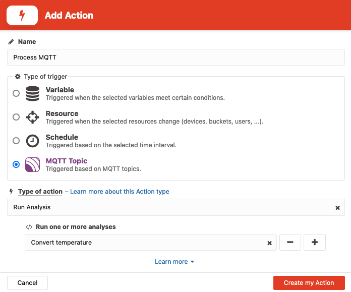

To initiate this analysis, we must create an action. Proceed to the Actions module and create a new action. Fill in the name, choose "MQTT Topic" for the "Type of Trigger," and select "Run Analysis" for the "Type of action." Then, select the analysis you have just created. Once all steps are completed, click "Create my Action."
Now let's configure your action. Under the trigger section, on "Select the device" select the device you created. On the "Trigger" field, type the input topic "sensor/input"s. After you are done, click on "Save".
By doing this, every time a message is published on the "sensor/input" topic, it will trigger the analysis you selected. Let's try it!
Publishing the message "32" on the topic "sensor/input" using the MQTTX client triggers the analysis, which converts the value to Celsius and sends it to the topic "sensor/output". This value should then appear in the client.
